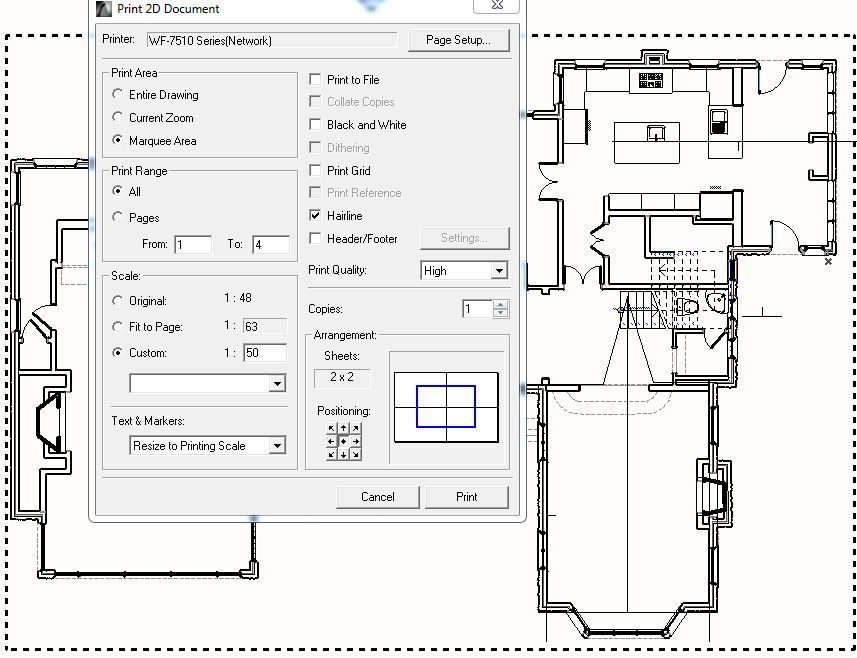

I have question why I cannot choose scale to print with a marquee area?
it is a bug or I am doing something wrong? Iam using archicad 19
Thanks

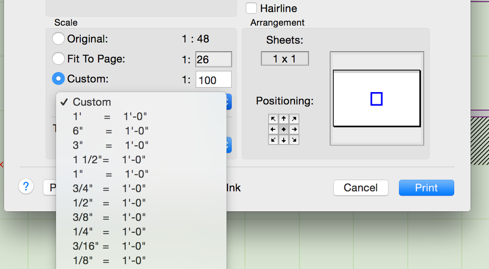

The tab for the custom scale is blank and the cursor is like a spinning donut.
Please any body else???????

If you choose feet or inches as model units in Options > Project Preferences > Working Units > Model Unit, the custom scales bar will be empty. In the US, these units are defaults, so there is no need to change them, except if you would like to try working with decimals. As a workaround till the public update, the custom values can be added manually.
