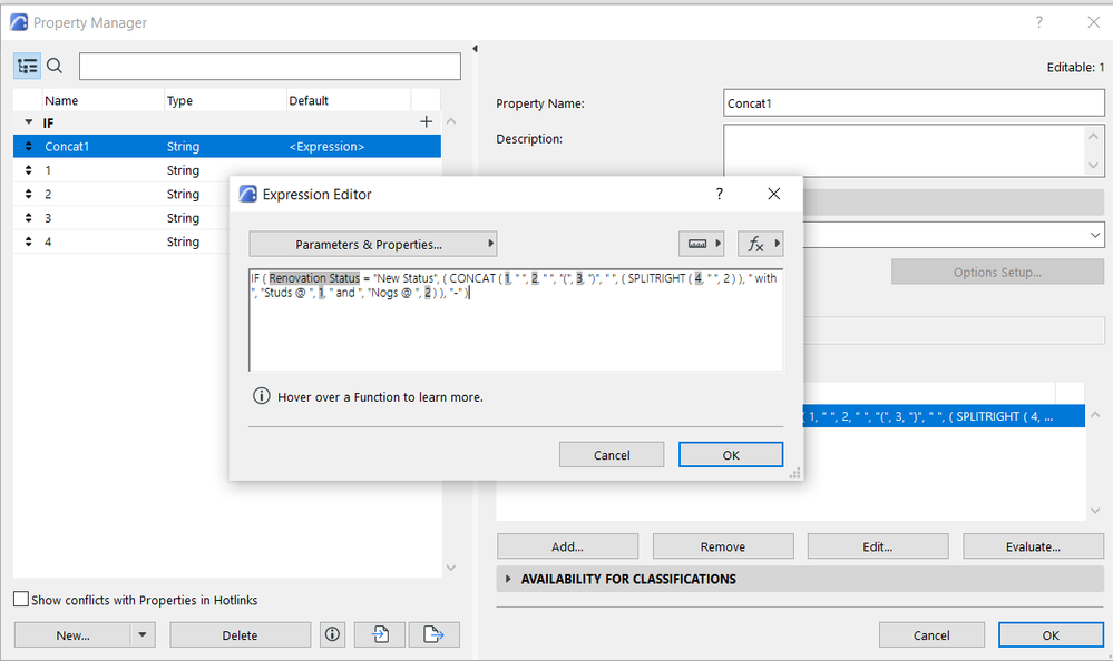

If it's of any use I have pasted the expression I have at the moment, where I have attemped an IF function, I'm cleary missing a fundamental step of how the IF function works wither particular respect to the "logical" field but not sure how to tackle.
IF ( {Property:CategoryPropertyDefinitionGroup/Renovation Status}=new, (CONCAT ( {Property:B1 | STRUCTURE/Timber size}, " ", {Property:B2 | DURABILITY/Treatment}, " ", "(", {Property:B1 | STRUCTURE/Type \/ Grade}, ")", " ", ( SPLITRIGHT ( {Property:ClassificationSystemPropertyDefinitionGroup/CBI Classification - Level 4 - 2019}, " ", 2 ) ), " with ", "Studs @ ", {Property:B1 | STRUCTURE/Studs}, " and ", "Nogs @ ", {Property:B1 | STRUCTURE/Nogs} )), - )

Hi, I think you have made simple mistake in typing by missing " " signs . Renovation  = "New Status" and a the end "-"
do try and let me know if I am able to solve your problem 👍

You would be better using the IFS statement instead of IF, which would be more direct. Make sure the return type is set properly and also the classification.

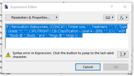

Thanks guys,  I think I'm getting closer.
I ended up trying the IFS function as I have 3x logical tests (reno status').
Have only entered two so far.
Below is what I have updated to, but still comes up with syntax error.
I expanded out to hopefully make it clearer, I also included the default IFS fields as a guide.

Actually even simplify the IFS expression is still producing a syntax error.

Remove the square brackets. Square brackets indicate the statements is optional and brackets should not be included.
Values are case sensitive Values should be "New" and "Existing"
