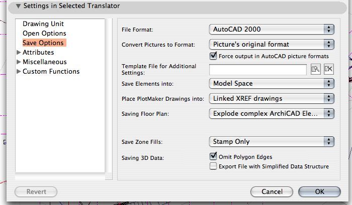

Publish file with hyperlinks as .dwg file
We are using Archicad 8.1 on Mac OsX - is there a way to save a plotmaker file as dwg and include the hyperlinks that are in the .pln file? When I publish as .dwg the resulting file is missing the hyperlinked info. The hyperlinks are attached in the .pln file - not bound, etc.

yes - use your dwg/dxf translator set-up to have plotmaker place drawings into linked x-refs. see the attached screenshot. i can't remember, but you may have to do this from within archiCAD: Tools>DWG/DXF Translation Settings because not all of the configurable settings are available in the open/save dialogues . . .

having read your post again, i think i may have misunderstood. it's the DWGs you're using in archiCAD as x-refs that you want included with the plotmaker file right? this actually works fine for me - the information in the x-refs are included with my DWG data when i save out from plotmaker.
or am i still misunderstanding, and you want the x-refs in archiCAD not to be included as a part of the archiCAD data, but for the x-ref file itself to be included with your plotmaker DWG?

To try and clear up my question:
We have a previous Archicad 6.5 project that uses .dwg x-refs - attached but not bound. We have now upgraded to Archicad 8.1 and OSX and are being asked to save all of those previous layout files (created with Archicad 6.5/Plotmaker) as dwgs. In the new version of Plotmaker when I try and save out the original .lay files as .dwg all of the x-ref info is missing from the new .dwg file that I created in Plotmaker.

Is the Xref infromation present in ArchiCAD?
** Yes - the xrefs show up normally in the archicad file
Is the Xref information present in PMKs?
** Yes
Do you see the PMK information in the layouts?
** Yes
What are the settings of your Translator in PlotMaker?
** I'm using the default translator
Did you try replacing the PMKs with views
** No - can this be done without doing any work in the original Archicad file? - we have 100+ sheets to do and are hoping to do everthing in Plotmaker.

I tried this and it worked for me.
Here is what I did:
1. Created a PLN file in AC 6.5 which had an attached XREF in it.
2. Saved the PLN.
3. Saved a PMK from it.
4. Placed the PMK on a Layout in PM 2.2 and saved it as DWG. The XREF data was there in the resulting DWG file.
5. I opened in AC 8.1 the PLN file.
6. Saved it under a new name as a AC 8.1 PLN.
7. I imported the view from that story in PM 3.1. The XREF was there in PM 3.1.
8. Published it as DWG. I then opened this in AC 8.1 and the XREF data was there.
9. Then I imported into PM 3.1 the PMK originally saved from AC 6.5 and placed it on a Layout.
10. Published the Layout as DWG. The XREF data was there.
I did this on a PC and it worked. Is there anything you are doing differently or should I do something differently?
Laszlo
The one thing that I am trying to do is open the existing .lay file (created in PM2.2) in the new PM 3.1 and publish as .dwg from there rather than your step 8 which creates a new layout file from scratch (it seems?). We have 100+ files to convert and want to minimize the time. We have Macs running OSX too.
