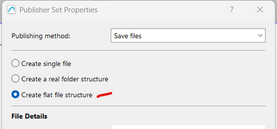

First of all, thank you to Barry, Karl, RyeJuan, and everyone who helped me troubleshoot this issue. I really appreciate all of your suggestions.
After hours of testing, the solution turned out to be surprisingly simple.
The problem was that my Publisher Subset did not have a Custom ID assigned (first image).
All I did was add "CRD" as the Custom ID (second image), and everything immediately started working. Publisher now exports both PDF and DWG files correctly.

have you tried selecting this option in the publishing set properties?
