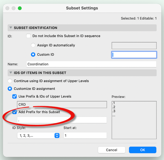

I'm experiencing a strange Publisher issue in Archicad 29 INT (macOS) that only affects one specific PLN file.
When publishing a Layout Book:
I've already tried the following:
The important part is that:
This makes me believe the problem is specific to this PLN file.
Has anyone experienced this before or knows how to repair the Publisher or project database without rebuilding the project?

First of all, thank you to Barry, Karl, RyeJuan, and everyone who helped me troubleshoot this issue. I really appreciate all of your suggestions.
After hours of testing, the solution turned out to be surprisingly simple.
The problem was that my Publisher Subset did not have a Custom ID assigned (first image).
All I did was add "CRD" as the Custom ID (second image), and everything immediately started working. Publisher now exports both PDF and DWG files correctly.
What made this so confusing was that Publisher always reported "Saved", created the folders and Xref images, but never generated the final PDF or DWG files.
I honestly thought my project had become corrupted and was already planning to rebuild it. What a relief!
Hopefully this helps someone else in the future.
Thank you all again! 🍻
‎2026-07-07 02:32 AM
So, as Karl said, any file beginning with a period will be invisible on a MAC system.
I am sure there will be a way to show hidden files, but I know nothing about MACs.
The files are there, just hidden.
By you adding the custom ID, the saved file name no longer starts with a period, so the files will not be invisible.
Still that is not the problem exactly.
You don't need the prefix if you don't want it.
Just turn off the "Add prefix for this subset" option or don't use the period as the prefix, use something else.
