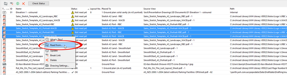

Hello, we insert a lot of PDF and DWG as drawings in our project files. It is common to move the whole project folder (where all the PDFs and DWGs are) to another path in the server. The drawings now appear as Missing. Everything makes sense. In older versions of Archicad (until Archicad 23) you where able to use de "folder relink" icon and relink all the missing drawings just by choosing the new root folder (where all the files are), and Archicad searched them inside that folder, even if they have differtent paths. It seems that this workflow is broken in Archicad versions 24, 25 and 26 as you have to choose manually each folder or file for every file to relink them. Before it was very easy to relink external drawings (PDFs, DWGs,...) in bulk, now it is a nightmare if you have large number of drawings to relink. Please make this procedure work again (or maybe I am doing something wrong). Thank you

If you go into the Drawing manager and select those files, do you have an option to "read from..." ?
Then you can select the main folder that contains all of your files and that may work.

That's my workflow, but only works if the files are in the same folder. Before I was able to select all the files in the same "root project folder" and Archicad searched in the subfolders for the missing files. Worked like a charm and now it doesn't.

All I can suggest then is to sort the drawing manager list by file path.
Select all those with the same path and use 'read from' on just those files.
You will need to repeat for each different path of course.
If some files are in the same folder there will be a slight advantage.

Thank you Barry, that's my current workflow. It's the best I found so far. Hope Graphisoft fixes this issue soon. Thank you for your interest.
