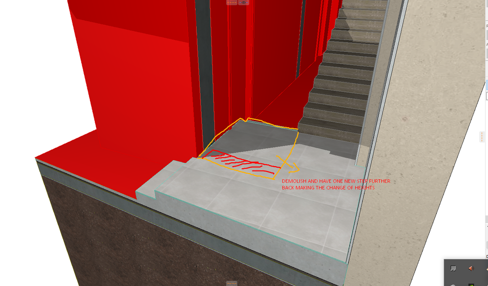

Hello!
Trying to demolish part of a slab to make way for new construction, happening where part of the slab existed, as in the pictures. How can i go about taking a chunk of the slab and show it as demolition? (actually its 3 slabs cause there are levels that i created with 3 slabs on top of eachother)
Cheers,
Z

It was me actually who posted that. I know its similar, but in my understanding there are some subtle differences that make it a different case to solve, in my view:
In the other topic we can just make a top layer of ceramic (for example) independent from the slab, assign it to be demolished, and make a copy of the previous layer with another material, lets say wood, and i can have a demolished ceramic floor and a new wood floor working fine on the renovation tool.
In this example i need to subtract part of the slab and flooring layers, (probably through SOE?) and somehow assign the chunk i just subtracted to "demolished", so i can have that chunk showing up on the demotions...
If the process is the same i am sorry to be duplicating it, but i thought it would be a different process, maybe involving SOE.

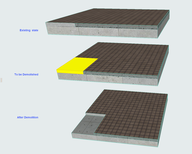

What I do is create a copy of the slab, create a hole in the original slab that is assigned to Existing, then edit the copy of the slab to fit the demolished part and assign it to Demolition. This gives me the correct display on the Existing, Demolition and New filters.

You can also model the demolished part, assign the "To be Demolished" Reno Status to it, use it as an Operator, and perform a Subtraction SEO on the existing Slab. They will be correctly displayed in the various Renovation Filters.

The slabs shouldn't overlap, the Demo slab fits inside the Existing one. Also check your MVO settings, there is an option for slabs to eliminate the line between slabs in 2D. My suggestion was mainly for getting the 3D model correct, 2D may involve some additional notation depending on your standards.
