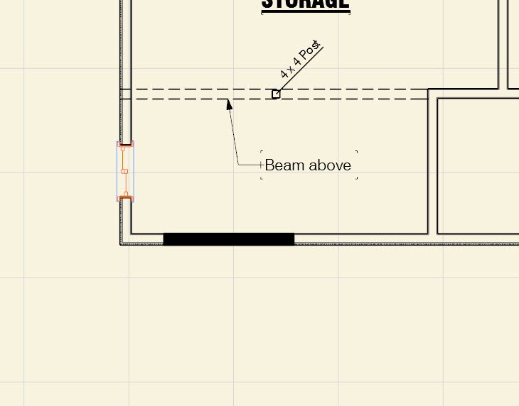

I have set windows to have a renovation designation of demolished with a fill override in the new construction view. When zoomed in, looks good. (See attachment.) Roll the mouse wheel a couple of clicks to zoom out, and the fill vanishes! What could be going on here?

Here is view with a couple of scroll wheel clicks.

I tried playing around with various 2D settings, and no change. The effect is the same for both GS windows and 3rd-party windows. BTW, I'm not changing the scale at all. Just zooming in and out. Fortunately, the fill appears to stay constant after the view has been sent to layout, so it's not a catastrophe. Just really annoying.

Yes, tried all that. Even tried a couple of different computers with different graphics cards. No change. The little preview of a sample floor plan looks perfect, too. I'm stumped.
What's a little weird is that I just tried it on a new plan with a GS Template, and I can't get ANY fill to display for a demolished window override. The new wall just stays hollow, even though the preview looks correct. Arrrggghh!!! I wonder if this was something introduced in the latest hotfix.

We checked the phenomenon that Richard mentioned in the post and it is indeed a bug. It has been scheduled to be fixed in a future ARCHICAD 18 Update.
