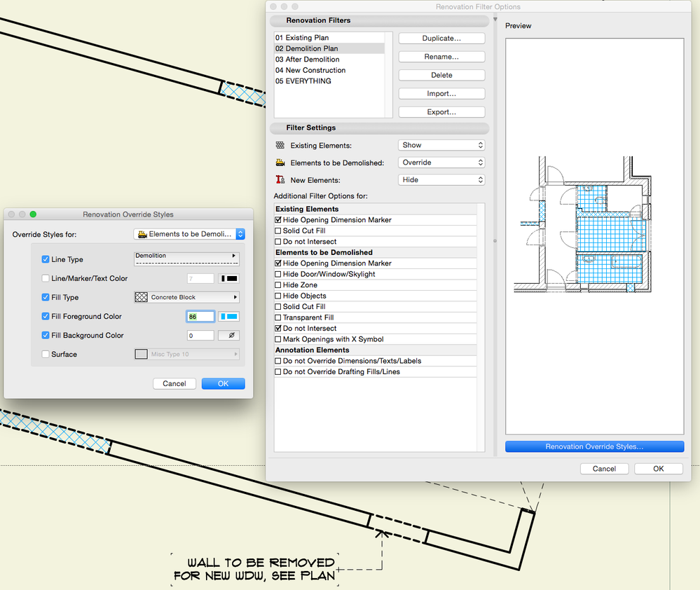

I have my existing conditions drawings complete. Then I want to demo walls, doors, etc. In the process of adding new openings to existing walls I see that the new opening will show up on my demo plan, but I cannot get the demo fill to show up for new openings the same way that the demo walls show up. I also (but related issue) can only seem to get the demo fill to show up if I use a building material with the demo fill. Trying to override the demo fill will only give me solid fills, no vectorial fills. Wish I could explain it more clearly.

It works here. In your 1st screen shot, you are showing the Renovation Override Style for New Elements (which are hidden in your 02 Demolition Plan renovation filter), not Elements to be Demolished, the Fill Type needs to be set there.

David thanks for pointing that out. However even switching the demo settings doesn't get what I was after.
I've had a hard time describing my intent, but basically I'm wanting to have any portion of any wall that will be demolished to show up the same. So any entire wall, or portion of wall, and any part of a wall that will become a new opening should show up with the same fill. However new openings placed in an existing wall to remain can't seem to be overridden as technically they are hidden in my demo renovation filter. Does that clarify at all.
