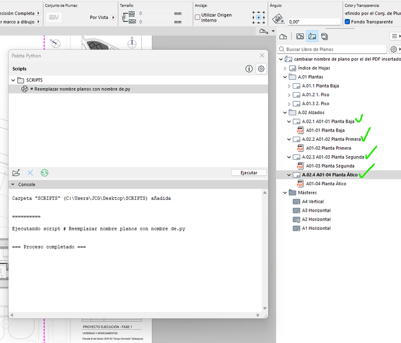

Hi to all!
I have a lot of layouts with PDF inserted.
Is there any way to replace the name of the layout with the hosted single name drawing (PDF) in?
Attached image to explain it
Thanks in advanced.
JCG
That's possible with Python.
The following script will rename all Layouts in a given folder (change it before running obviously) to their first placed drawing.
Caveat: It is currently impossible to tell what kind of drawing is placed on a layout! So this will cover internal drawings just as well as external PDFs.
That's why it's needed to restrict this to a given folder. It's also undoable. So please beware.

Thanks so much, Runxel.
I've been meaning to learn Python to use with Archicad, and I think the time has come.
Archicad 25 SPA v6000
i9 14900K/32 Gb DDR4/1TB SSD/10GBPS Lan/Windows 11 PRO
cagarruta
Awesome Runxel!!
it works at first time!
thanks a lot!
