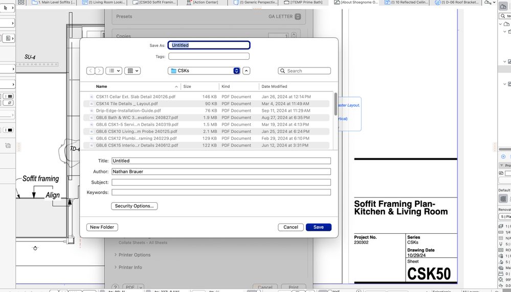

In Archicad only, when I print and save to a pdf, the default file name is "untitled", as opposed to whatever layout or view I'm working in.  Other software give a relevant file name.
It's annoying to have to type the name of something other software seems to be able to work with.
Is this a work environment thing I changed by mistake?

ps. When I Save As a PDF, the default name is the file name or the drawing type... ELEV for elevations, *Section Name*, *3D Document Name*, *Schedule Name*, *File Name* for floorplans and 3Ds. Is this an external PDF printer that you are using?
nbrauer718
Problem solved.  Yes, an external pdf printer.  I deleted the printer driver(Kyocera) and installed a new one from their website.  PDF file is no longer defaulting to "untitled."
