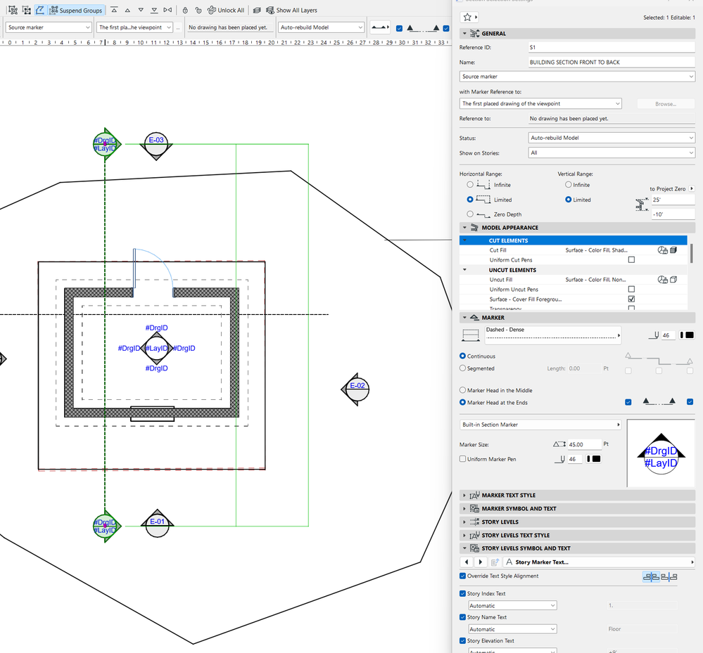

Section Markers do not match what is set up
Eric Milberger
I cannot figure what these new section markers do NOT match the settings
Eric Milberger, Architect | Master Planner
1 ACCEPTED SOLUTION
Solution
What is not matching?
If you are worried about the '#DrgID' & '#LayID' then have you place the section view on a layout?
1 REPLY 1
Solution
