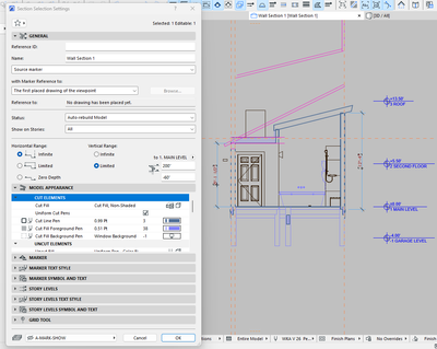

I think you will find the section height range is set to 'Limited' and it has zero height.
Tom Krowka
Hi Barry....I don't think the solution you proposed works.   See pic above.   Thanks Tom

Now that I look at your first image closer (3rd cell), you can see the range limit on the right with the storey markers outside of it.
But in the second image you post, there is no change at the storey marker limit.
If you switch it temporarily to "Infinite" vertical range, does it change?
It can't be the background colour because that would affect all views.
I am not sure what else it can be.
Tom Krowka
Changed to Infinite range.   No change in the background. TK.
