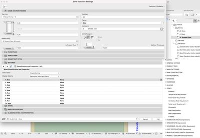

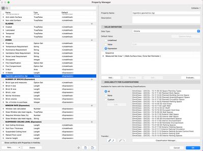

Edoardo B_
Here's the property expression
And it works technically
Here is the zone classification that matches the one of the property
And here's what I finally see when I try to add the property to the zone stamp (nothing)
Finally I use AC25 INT Build 3011.
MacBook Pro (15-inch, 2016) / CPU: 2,9 GHz Intel Core i7 quad-core / RAM: 16 GB 2133 MHz LPDDR3 / GPU: Radeon Pro 460 4 GB / macOS Big Sur (v. 11.6)
This is curious. I reproduced the settings from your screenshots, and indeed, the Property returns a correct value if I select a Zone and evaluate the Property in the Property Manager Dialog, but for some reason, I can not select it to be displayed as part of the Zone Stamp.
Why this is is beyond me so I will forward this to GS and we will see if they have an answer for it.
