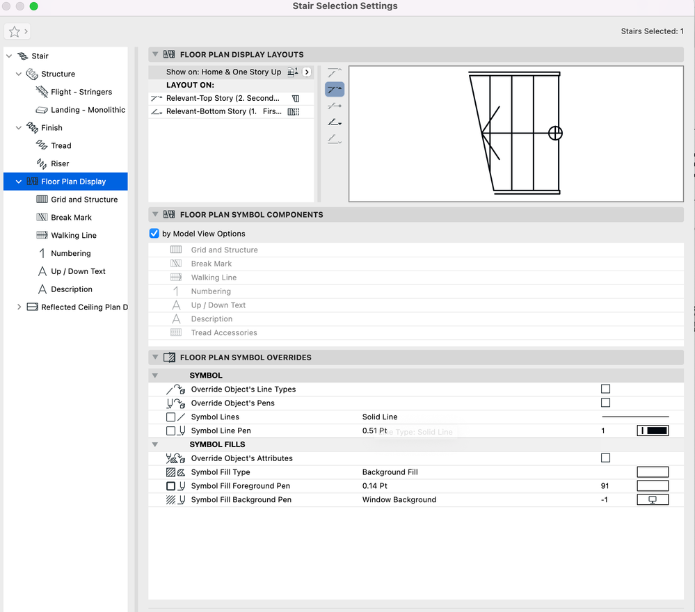

This way it works.
[The stair is placed on its bottom story, and set to display “Home & One Story Up”. Anything below or above, in the unlikely case it is needed, shalt 2D be.]

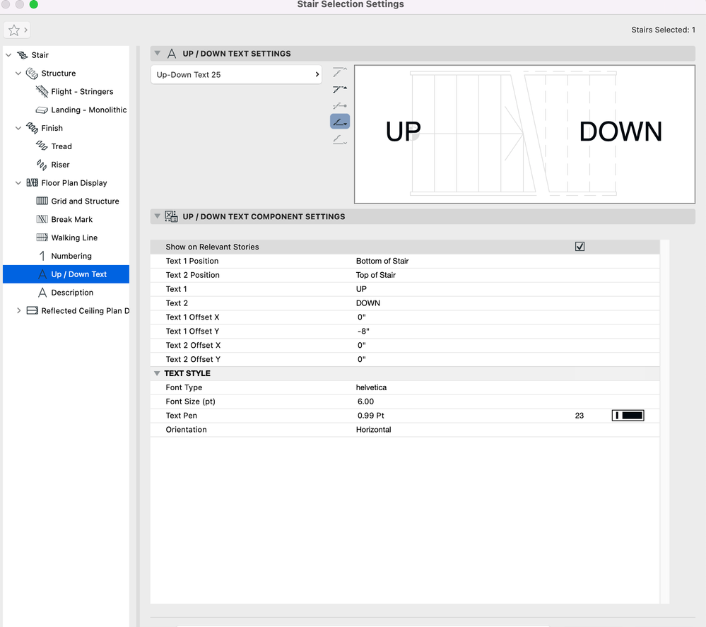

Interestingly it looks like they blew away some of the Up-Down text functionality in AC25!?  See attached screenshots.  What a BUMMER!!
Screen Shot 2022-02-24 at 7.53.20 AM.pngScreen Shot 2022-02-24 at 8.01.13 AM.png

Chris,
In your first screenshot, the "Show On" field is set to "Home & One Story Up". Both of these Stories are "Relevant Stories" because the 3D geometry of the Stair goes through these Stories.
In the "Up / Down Text" page, the "Show above Relevant Stories" and "Show below Relevant Stories" options appear only when they are relevant.
For example, if you set your "Show On" field to "All Relevant & One Story Up" option, and your Project has a Story above the Top Relevant Story of the Stair (e.g., the Stair goes from Story 0 to Story 1 and your Project has a Story 2), then the "Show above Relevant Stories" options will appear on the "Up / Down Text" page because they make sense and you can set them.
I hope this explanation makes sense.
Thanks Laszlo...  I understand now.  Unfortunately that doens't really help solve the problem of having the "down" text only show on the upper level, while the "up" text appears on only appears on the lower level.  That got the walking line to work... maybe the text representation will be next?
