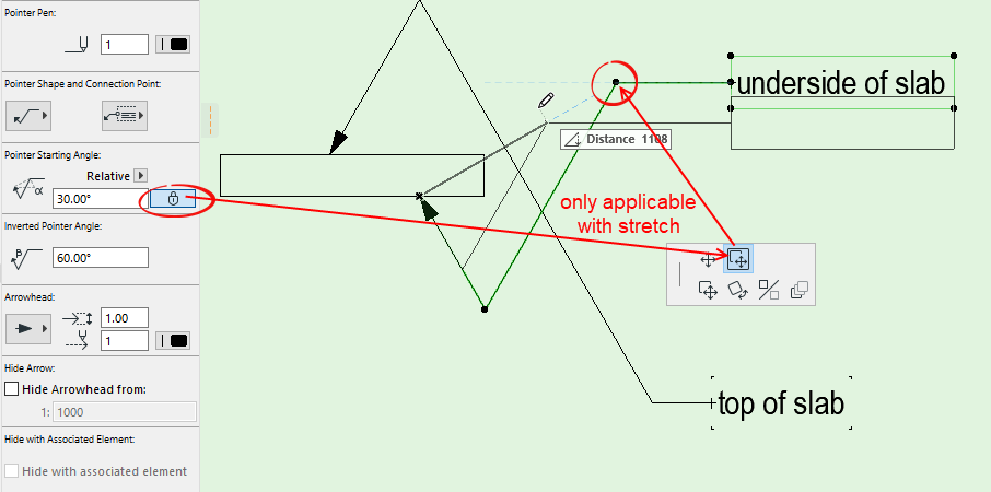

Whoever designed the label tool multi node pointer line was clearly an active sadist, or more kindly, someone who has never documented a drawing.
There seems no obvious or intuitive way at all to adjust pointer line nodes dynamically in a way that gives a useful result.  Rather than dragging nodes to shape the pointer line, user is apparently forced to open object properties and manually enter angles for each kink - and even then it seems to be impossible to achieve desired the result (90 degree bends for all kinks - per screenshot below). No combination of angles entered seems to work, and the middle node of the pointer line cannot be adjusted via hotspot.
If anyone can show or tell me how to get this to work, I would be most appreciative!

It is not meant as a multi-line pointer, it is an inverted pointer.
So if you annotate above the first point clicked it will invert and point from below.
And if you annotate below the first point clicked it will point from above.
The 2 nodes next to the text adjust the same as a normal pointer.
You can't adjust the angle of the inverted part on screen, but you can set it in the properties.
The starting angle lock seems to only affect the middle node when using the stretch movement in the pet palette.
I agree though, being able to adjust the position of all 3 points directly on the scree, would be nice.

The main motive I can see for even wanting to use a label pointer with more than one middle node, is to deal with tightly packed drawings where there just isn't enough free space to place both the label text and the pointer line in a cleanly adjacent location with respect to the item being described.
Attempts to address this scenario with this multi node pointer are inherently frustrated by mandating diagonal pointer line segments, because these then require if anything much more horizontal separation between label pointer start and end points.  If there was that kind of horizontal gap available, then a standard label pointer would usually already suffice.
