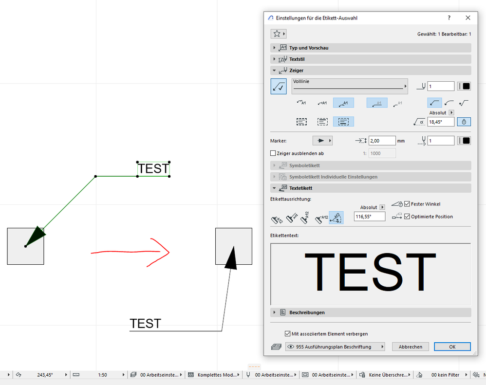

How to set Label Pointer Angle for automatic labelling?
Hi!
I'm trying to find the right settings for a label used for automatic labelling.
But no matter what settings I use, the angle of the pointer always changes to something weird.
On the left is the manually set label, which I then use for automatic labelling of the right column.
Can someone help me with that?
