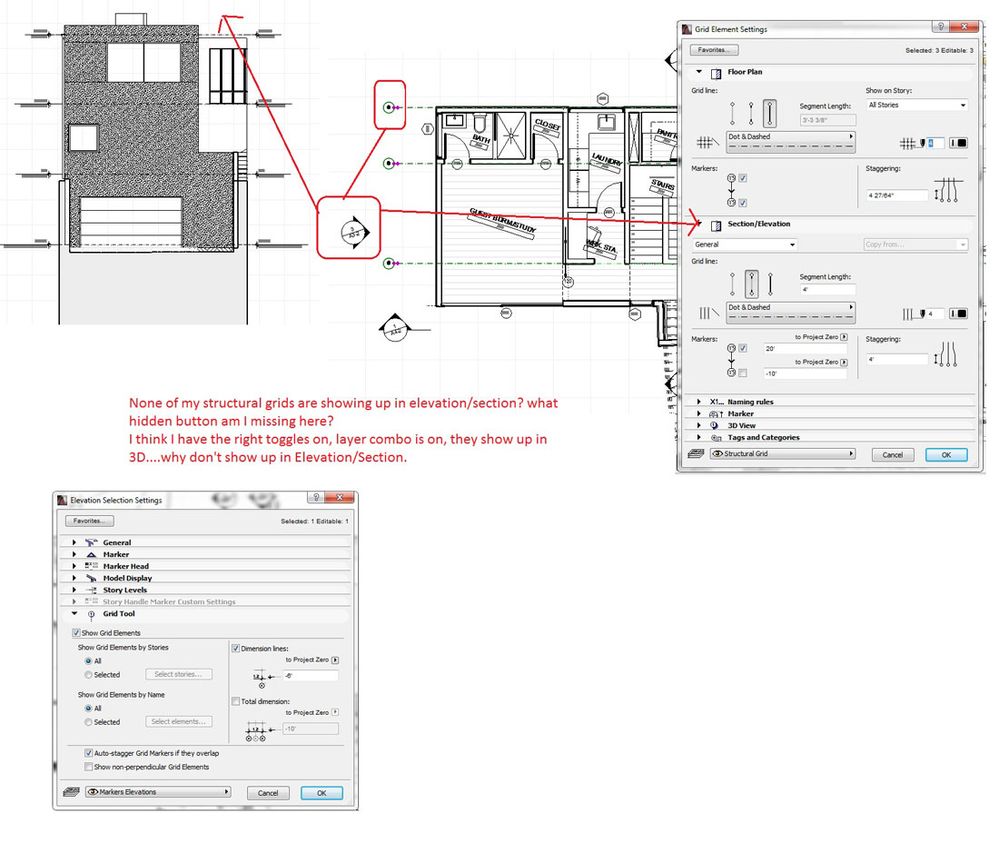

basically, I've toggled all toggle-able (sp?) buttons on both the grid, the section marker, the elevation marker, the layer combo...and still can't get my structural grids to be displayed in neither elevation nor section views?

Try clicking the "show non-perpendicular Grid Elements" button,
in the "Elevations Selection Settings".
EDIT:
That worked for me with the Section tool... but not with an Elevation.

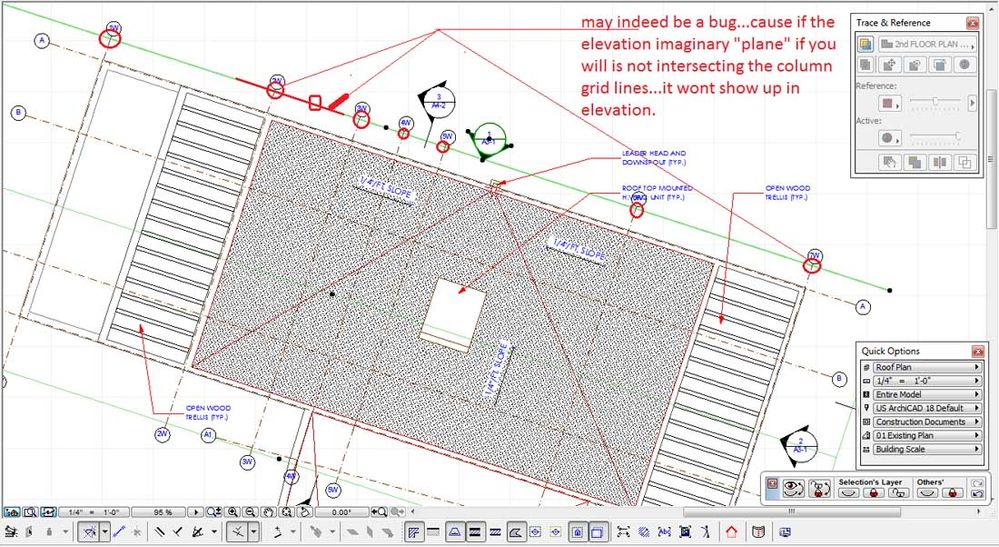

Yea... it does work ... if the Elevation marker lays over the grid in plan.
Make sense?
It's a bug (i think).
Marc Corney, Architect
Red Canoe Architecture, P. A.
rob2218
Thanks Marc,
you may be right about the "bug" thing.
it appears that if the imaginary elevation vertical plane is NOT touching any of the column grids in plan....then the grids will "NOT" appear in elevation.

Rob, maybe the best solution would be to make sure that your Section Line exactly perpendicular to those Grid Elements. Seems like currently they are not.

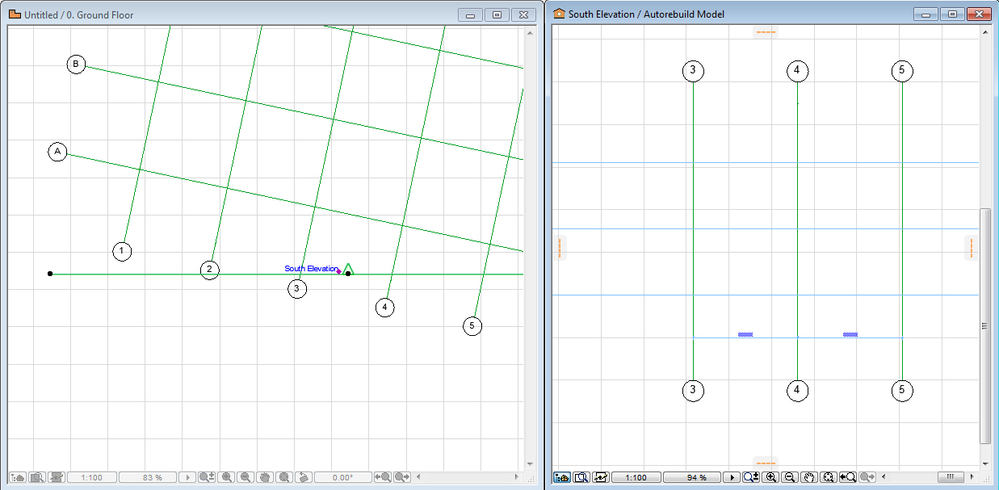

Yes, Section, Elevation and Interior Elevation Settings Dialog's have the "Grid Tool" panel, which at its top has the "Show Grid Elements" checkbox. When it is checked the panel's "Show non-perpendicular Grid Elements" checkbox also becomes enabled and you can check it.
However, there is an additional condition: the Section/Elevation/Interior Elevation Line actually has to intersect the Grid Element. This is necessary because the Grid Element will be show in the Section/Elevation/Interior Elevation at the position it intersects the Section/Elevation/Interior Elevation line.
If they don't intersect (many time a case with Elevations) they will not be shown in the Elevation even though the checkbox is checked in the Settings Dialog.
In the attached image the Elevation line intersects only non-perpendicular Grid Elements 3, 4 and 5, but not 1 and 2. Thus 1 and 2 are not shown in the Elevation, while 3, 4 and 5 are shown, each at the point where it intersects the Elevation Line.
