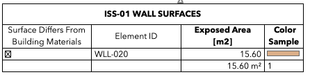

I have a wall from 0.0000 to 4.000, i.e. 4m tall. It's 4m long. I have painted the internal surface with Surface Painter, so I've got 4x4 = 16m² of painted surface.

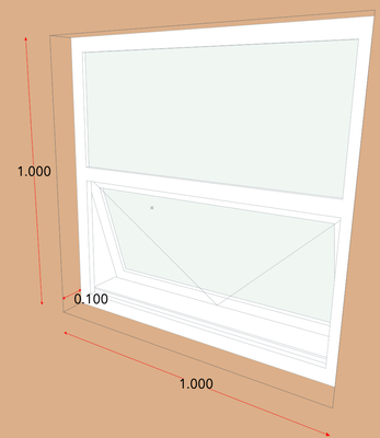

Now, I add a 1m wide by 1m tall simple window, at a 10cm reveal from the internal wall surface. That means that around the window hole, I have a wall surface going into the reveal, the total of which is 4x(0.10x1.00) = 0.40m².
I have set up a wall surfaces schedule. It picks up walls whose surface differs from building material. I list the 'Exposed Area (By Criteria)' field. I expect to see in my schedule a total of painted surface for that wall equal to 15.40m².
But it lists it as 15.60m². That is 0.20m² more than I expected. What am I missing?
I have confirmed the following:
The window is 1m x 1m. Reveal is exposed 10cm around the window frame on the inside of the wall.
The schedule correctly measures the painted surface of my wall as 16m² when I have removed the window.
It also correctly measures it as 15m² when the window is replaced by an Empty Opening.
Thank you.

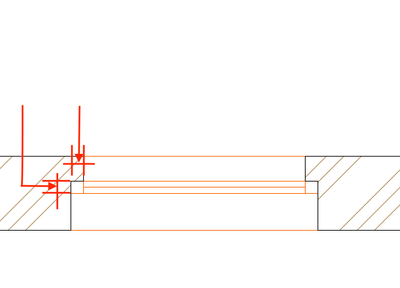

It could be the type and configuration of the reveal.
I hope this helps.

Unfortunately, Archicad also calculates these surfaces
