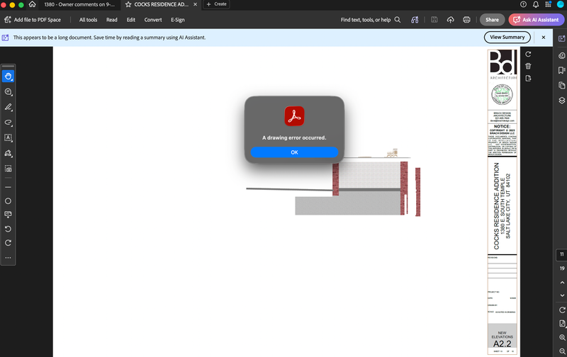

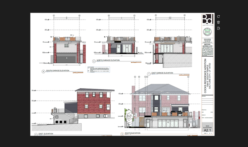

setting to 72dpi seems to help a bit.  I have two elevation layouts: and one hesitates, then shows, the other shows an error.
