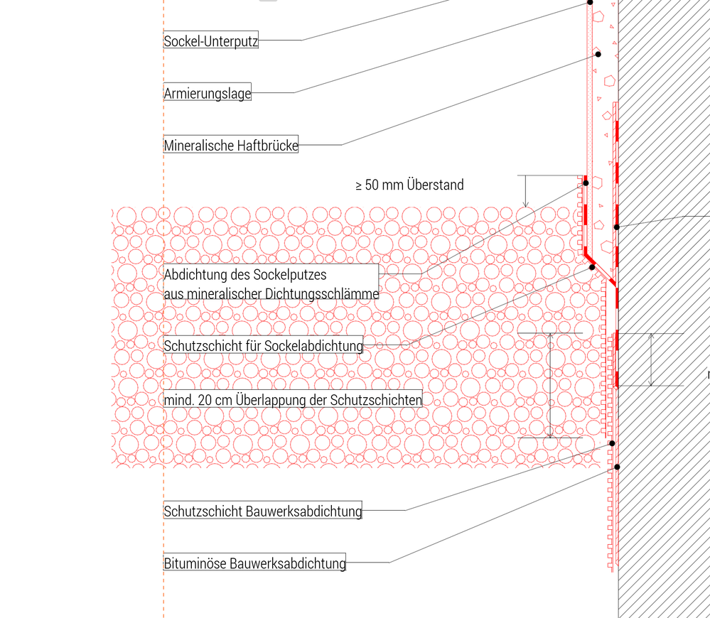

My colleague and I have run into a strange issue with the Text tool in Archicad.

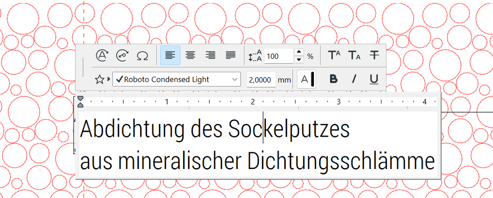

I made some annotations for a detail view using the Text tool. On my screen, everything looks correct – the text fits nicely inside its background box.

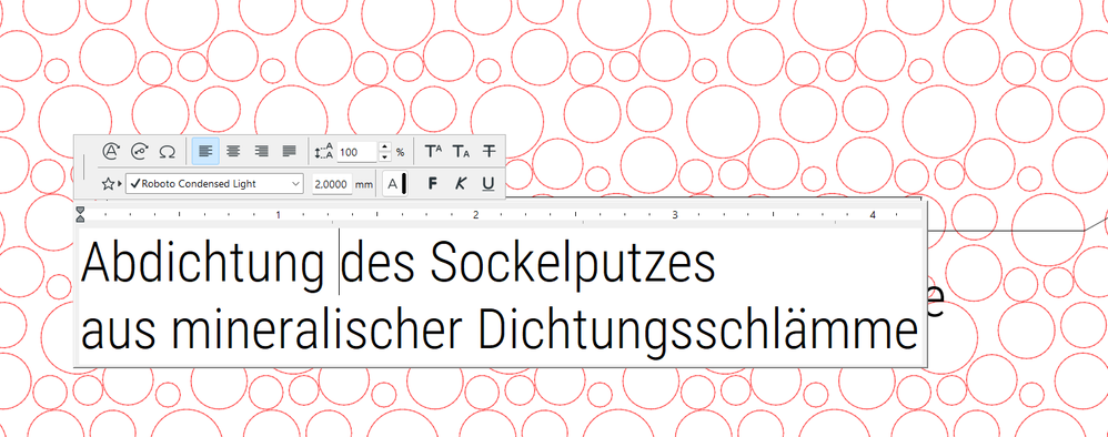

However, when I send the changes, my colleague sees the text shifted – it appears outside the background box (see attached screenshot).
We are both working on the same Teamwork project. Has anyone experienced this before? Any idea what might be causing the text to display differently on two different machines?

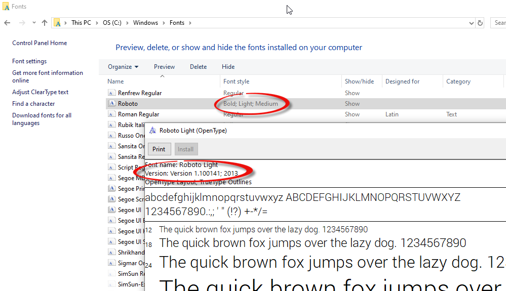

On the machine that is wrong, I would delete that font.
Then copy the font from your good machine and re-install it on the bad one.
Be sure to re-start Archicad.
I am wondering that although you have the 'same' font, it may have been downloaded from a different source?
You could always look at the font properties to see it is the same version.
The same font should behave the same on any machine.

Heftor
Hi Barry,
Thanks for this, we have check the font versions across the company and indeed we are using 2 different ones.
Thanks for pointing us in the right direction 💪,

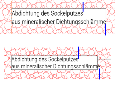

Do you both have the same fonts installed?
One see slightly wider than the other when compared to the circles in the fill.
But the text boxes are the same.
Maybe you have a narrow version and you colleague doesn't?
When both of you select the text, id the [font name] in square brackets?
That means you do not have the font installed.
Heftor
Hi @Barry Kelly ,
Thanks for your swift reply,
We were looking into it and we have both install the font
Mine text:
My colleague´s text:
Thanks again,
Hector

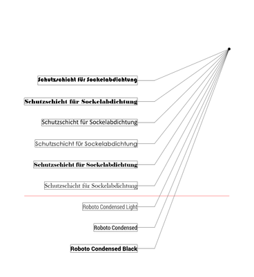

Now we have made an additional test:
We compared different font types – Arial, Century, etc. – and they all work fine. The only font that is causing problems is Roboto Condensed Light. Even the rest of the Roboto family (Regular, Bold, etc.) works without any issues. The problem is specifically isolated to Roboto Condensed Light.
My computer:
My colleague:
So the issue seems to be font-specific. The strange part remains: two colleagues with the same German version of Archicad on Windows see the same Roboto Condensed Light text differently – one correctly, one misaligned.
Has anyone experienced similar issues with Roboto Condensed Light in Archicad? Could this be related to how different Windows machines handle this specific font weight or style (e.g., one machine having a corrupted font file, or different font file versions)?
Thanks again for any help.
I have Roboto font on my machine, and this is what I see in the preview.
Heftor
Hi Barry,
Regards,
Hector
