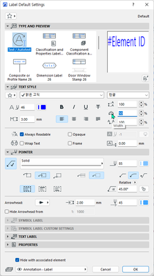

The dimension input becomes strange. I'm trying to hit 1000, but if I hit 100,000, it turns into 10
I'm trying to hit 1000, but if I hit 100,000, it turns into 10.00?
Even when editing, unexpected dots appear on backspace or del keys. Is it just me?
AC25 5010 / AC26 4019 on window 11

2.  in label
These three send a warning message when backspace. It seems that almost all warning messages are sent out when pressing the numeric keyboard.
Is it just me?

Like I said, if you select the letter at 100% and press 8 to enter 85, it will be 50 and you will hear a beep.
Solution
Now I can see what you are doing, I tried it myself.
8 is not a valid value (too small), 50 is the smallest it will accept.
But as Ling mentioned, there is a time delay to allow you to input values.
If you type too slowly, it will assume you have finished, and will accept the value.
So when you type 85, if you pause long enough after 8, it will accept that as the value, but because it is too small, it will change to 50.
In the Work environment, you can set a longer delay.
If you set something like 5 seconds, you don't have to wait 5 seconds every time you change a value.
Just move on to another setting or 'OK' and that value will be accepted.
It will just give you a little longer to type in a value before it is automatically accepted.

I changed it because it is set to 0.00 seconds. ^^
