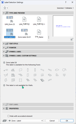

After specifying two properties that I made in zone label, it became like this in all programs.
What should I do?
AC27 on window 11

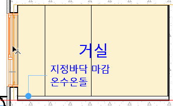

If you have an independent Label, you can select it, then CTRL+click an element to associate the Label to the element. In the case of a Zone, it is best to select the Label, then CTRL+click the Zone Insertion Point (looks like a + sign, but appears only when the Zone was placed with either the "Inner Edge" or "Reference Line" geometry method) or the Zone Boundary polygon to create the association.
If you have an associated Label, you can select it, right-click and use the "Convert to Independent Label" command of the context menu to make it independent again.

From what it looks like there, the wall might be labelled instead of the zone. I don't think this label can be used on a wall. If you hold shift then hover over the label, you will see another element highlight in blue. If the wall highlights, then it means that label is associated with the wall and not the zone.
If you are trying to label the zone, use the eyedropper to pick up the label hover the zone until it highlights blue and then click to label. Delete the old label.

I've noticed that once a label is created in an unlinked state, it cannot be changed.
It said that I had to change it only in the label setting.
