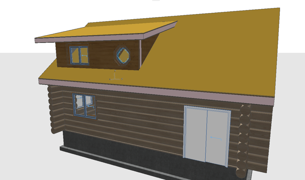

need a little guidance on 2 items one related to topic and the other not. would like to clear out the main roof within the loft roof and you can see looking through the window that the main roof is visible and trying to figure out how to remove. second question is in regards to the sliding door shown in lower right of image. can't seem to find how to make the sliding door show clear glass in the object settings interface.

You could select roofs, right click > Connect > Trim Elements to roof shell, but the hole will be the size of the upper roof.
I would just use the pet palette option to cut a hole in the main roof.
If that is a door and not a window, check the MVO settings for detail level in 3D - may not be 'Full'.
thanks for the hint and mvo was good but did find the glass clear selection under leaf surface to solve my problem. still working on roof and will try your recommendation if unsuccessful.

just wanted to thank you for getting my brain to engage and found these 2 links helpful and solved my problem.
https://helpcenter.graphisoft.com/user-guide/76493/
https://www.youtube.com/watch?v=XTY-zJuEtH0&t=1s
