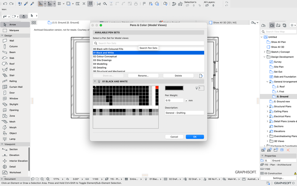

I don't know how to fill a wall with black color. When I select black color option from pens and colours, nothing happens. Can you please guide me on how to fill the wall with black color?

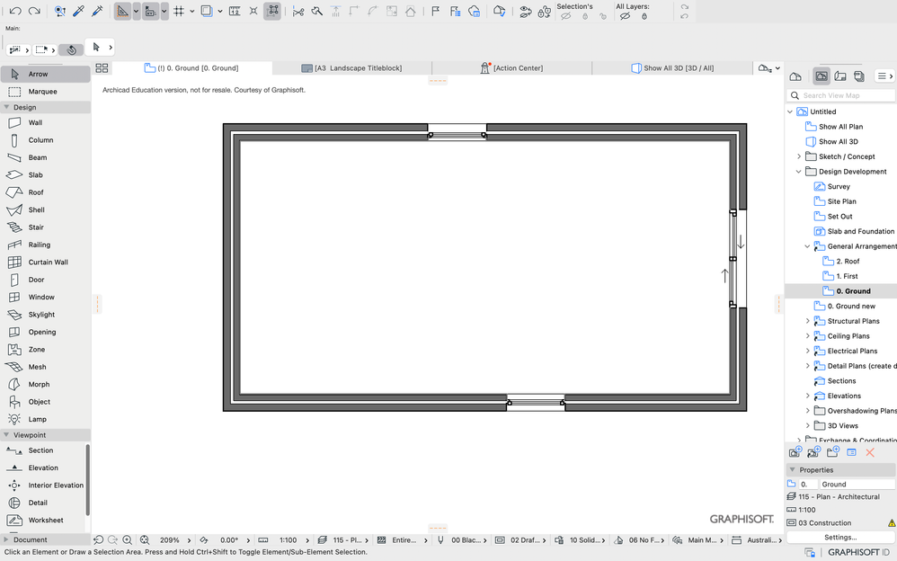

You still need to use a graphic override, but one that just changes the fill type to solid.
Then change the pen set you are using.
If the cavity building material has a coloured pen - you need to make that white in the new pen set.
Otherwise if you change the building material so the cavity has a white fill (I would do that) then you leave that white pen as white in the new pen set.
So the GO will change all of the fills to solid.
Then the pen set will change the pens to black.
The GO also changes the cavity to a solid fill, but because the pen is whit, you won't see it print.
Thanks Barry for explaining. "I have followed all the steps you suggested, but the walls are still appearing as dark gray not black.
