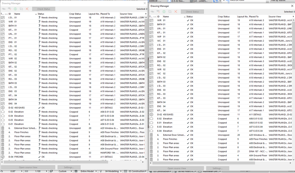

this is snippet of 2 Archicad files the left is the one that having the issues.
please note that both have same hotlinks, libraries and from same template.
this snippet was taken literally after i refreshed and opened the drawing manager again.
the one on the left gone back to needs checking, the normal file is showing OK.
now this is driving me crazy lol

Bojan Fratina
I have had the same (or similar) problem multiple times over the years, across multiple AC versions. Drawings on some layouts would auto-update even if no changes were made to the model, even if I just switched to a different tab and back or to a different program and back. I wasn't able to find the source of this problem until today.
Today I was able to find the cause of the most recent instance of this issue (no idea if this has been the cause of all of them or if this issue can have different causes). On a layout that had this problem, the source view of one of the drawings had a missing penset. Once I reset the penset for that view, the problem ceased. It is enough to have only one drawing with this problem on your layout, that drawing will always automatically update when you open the layout, then after it is done updating, this for some reason triggers an update of all the drawings on the layout (hence why some drawings get updated twice; if all drawings have this issue, then all of them get updated twice).

I had a certain layout in which certain drawings were conctantly updated even after I closed and open the layout.
No chnages. No nothing.
@Bojan Fratina made me start thinking so I checked my pensets and all were OK.
BUT THEN.... I checked my design options and some of them were "Custom".  After setting a certain design Option the drawings stopped updating!!!!!!!!!!!!!!!!!!!!!!!!!
I guess this has to be checked some how by others who are facing the same problem of constant updating.
