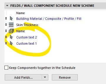

I have found that the Wall component schedule does not matching Wall composite profile.
This is rather worrying....
I seem to have 2 additional layers in the wall schedule that does not exist in the composite profile.
Am I doing something wrong?

Back to this issue....
I still cant solve the additional items in my schedule.
I've scheduled "Custom text" because I need it, but this causes Archicad to duplicate the skin in the schedule.
The 2 skins circled in yellow does not exist in the wall type.
But when I delete the custom text underlined in green, the schedule is correct.
But I need the custom text.
Is there a different way I can add text in the schedule for additional descriptions?
