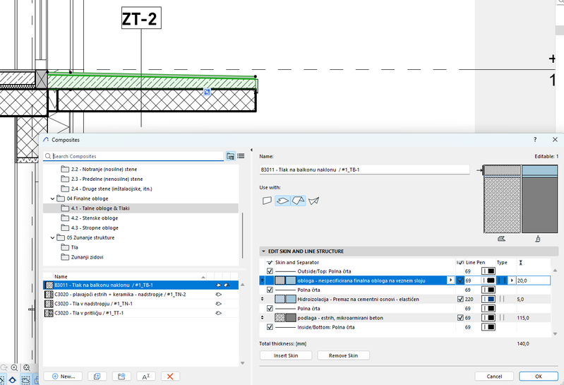

Listing composite skin thickness in unit other than set calculation unit.
I would like to create a property that reads the thickness parameter of skins that form composite structures and convert it from my default calculation unit (meters) to centimeters in my schedules. I went to property manager and when I wanted to create an expression for conversion, I cant find the component thickness parameter. Can anyone help?
I don't want to change my calculation units as a global setting because I use meters for all my quantity takeoffs and I need centimeters just for this specific case.
Ideas appreciated!

Unfortunately, Properties can only inquire and generate data about entire elements, but not about subelements, groups of elements, or other elements.
The thickness of a composite skin is subelement-level data so you cannot get it with Properties.
You can get the inside and outside skin thicknesses in properties.
Also the thickness of skins tagged as air or insulation (this is set up in Project Preferences > Calculation Units & Rules > Conditional Parameters).
But as Laszlo said, you can not get all of the skin thicknesses.

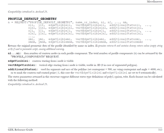

Why just the inside face and outside face?
That reminds me of the "PROFILE_DEFAULT_GEOMETRY" command in GDL.
Why?
We want to know the current geometry of the placed profile, not the default unplaced version...i can't seem to find that command...

The original question has nothing to do with GDL.
It is about Properties and Expressions.

Hi all,
After some playing with materials, properties and labels, Ive managed to come up with a method of reporting composites that suit my deliverables. It was a fun exploration process I would like to share:
Skin list label allows you to choose units for reporting thicknesses. If you duplicate one of your views that contains most (preferably all) of your composites and set the units (in view settings) to centimeters, the skin list label will display the skins in cm with proper alignment of numbers. If you look at my skin list label below it has everything turned off except the description of the building material and thickness. The name of the composite and thickness are actually another label (green boundary), which just contains some auto-text (keynote, title and thickness) in bold text.
One good thing about using the description property of materials is that it allows you to use the description for external/public purposes (specifying your materials). and using the material name for internal/company purposes: organizing your materials, finding them quickly using text search and most importantly keeping copies with different intersection priorities of the same physical material. This way, I can have 3 versions of the same material with "+" extension for hi priority, normal without any extension and "-" for low priority and the same description "thermal insulation, XPS" for example.
How about if you model your assemblies using 2 or more composites? Sometimes this is the easiest way to achieve proper representation of roof eaves and necessary if you want to model a balcony slab with inclined flooring for example. In this case you model the structural part and bottom finish using the slab tool and one composite, and the top skins using the roof tool in 2% slope and another composite. With SEO subtraction you then finalize your assembly. You can report such assemblies by stacking skin list labels in appropriate order that corresponds to the sequence of skins. The only two things you have to keep in mind is rearranging the placement of skin list label if you add/subtract a skin and recalculating the sum if you change any thickness (I'm planing to do another property that would automatically sum composites that constitute the same assembly.

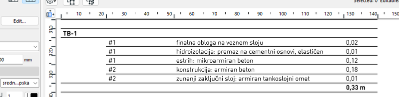

In schedules however, it is possible to list two (or more) composites that form an assembly in a unitary way:
As you can see in the schedule above, both of my composites are merged into one assembly, which is fantastic. You achieve this by giving both composites the same keynote (TB-1 in my case) and numbering them (#1 and #2) so that schedule can sort them in appropriate order. Keynote and ordering number are written in the names of my composites (seen in the images above) and extracted with SPLIT expressions.
Some concluding notes: schedule must have "merge items" option turned off, "show headline" turned on. For thicknesses to be reported properly it is important that the schedule lists only one instance of certain type (assembly), otherwise the SUM function will start to add the thicknesses of all skins that it finds in the model (your 20 cm of insulation that you have in your typical wall will be multiplied by the number of instances of this wall type and you will get hundreds of cm of insulation which we dont want). You can prevent such mistake by creating a property called sample composite of a true/false type and having false as the default value. Then go to the model and choose one instance of all your wall, slab and roof types and change the property to true and set up your  components schedule so that it lists only elements with the value of this property set to true. Sometimes the schedule wont display the correct composite order. When this happens, go to scheme settings, click on "keep components together in the schedule" option, click OK and then go back in and uncheck the same option. It should work fine.
You can now export the schedule to Excell and convert the thicknesses to cm, which you can do with and expression. Still double check your values because vapor barriers, foils and other thin materials get reported as 0.00 thick. These items you have to manually correct. You can avoid this hassle by publishing your assemblies directly form Archicad by placing views with skin list labels on layouts, format them in groups (floors, roofs, walls) and publish them to PDFs.
