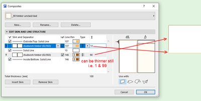

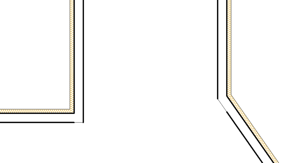

Has there been a solution found to this problem with the latest versions? Because I think I have the exact same one
2022-02-16 03:54 PM
Make sure the end lines are on in the composite settings and the pen matches the pen of the side lines.
If you have two different pens for the side lines as in the first post, then the only way I know to automate this is to split one skin into two skins (half thickness each).
This allows you to have a different end line pen for each skin - again that matches the side (skin) line for each skin.
The only downside is the free end of a wall if it is not joining something else.
There will be 2 pens at the end.
Not really a problem if the side skin lines are different as it is just highlighting the different sides of the wall.
If the side line pens are the same (as in your case by the looks) then there is no need to split one skin into two.
Just make the end line pen the same (and turn it on).
But you can also make one skin thin and the other wider (equal to the original one skin) to give the illusion of a single line at the end.
