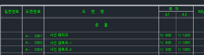

We use A3 scale and A1 scale in drawing list.
Is there a way to display both in the Sheet Index?

I'm thinking of doing the drawing on A1 and working on A3 with 50%. however
There should be both original Scale and drawing Scale, but I asked because it doesn't seem to work.

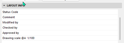

I think it's a local customary to indicate multiple drawing scales for different print sizes. We're often required to include them in our drawings as well in our region.
ArchiCAD can only show a single drawing scale based on the layout size. If you need to indicate an additional alternative drawing scale based on a print size that differs from the layout size you'd have to add it manually. The least painful way I found was to use the layout info in the layout settings:
Right click on the project title (the top group) in the Layout book in the Navigator and and choose Book Settings. Click on Add button under LAYOUT INFO SCHEME to add new info item and call it "Drawing scale @A1", or whatever, and hit OK.
Right click on the layout in the Navigator and open layout settings and under LAYOUT INFO you manually enter the alternative drawing scale in the info item you created. You'd have to do this for each layout.
The layout info item can be displayed as as a field in the drawing list, or as an Auto Text in the title block.
It would be great if GS will make alternative drawing scale parameter available.

I think I understood what you said.
Set the drawing scale, insert the drawing scale @A1, and enter it manually.
And that's what makes this visible in the Sheet Index.
thank you. ^^
It doesn't work automatically. ㅠㅠ
