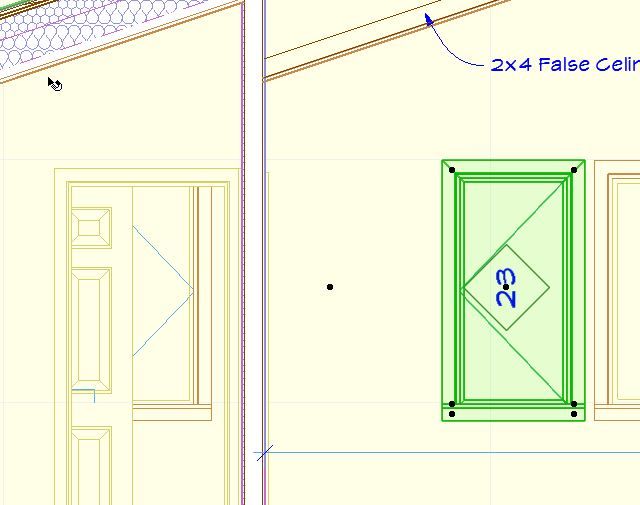

I decided to shoe the ID Label for the Windows when they are viewed in Section. This worked properly for a Section that was cut facing up to plan north, but for sections cut facing to left (plan West) or to the right (plan east) the marker is rotated.
Screen shot is from a Section facing to the plan right.

If I rotate the Label either 90° or 270° I get this result.
Label Spec
Section facing plan north (upwards)

In AC18, using the Label-Door Marker 18, I get the same result. I get the correct orientation using the Label-Window Maker 18. (I did not test this in AC17).
