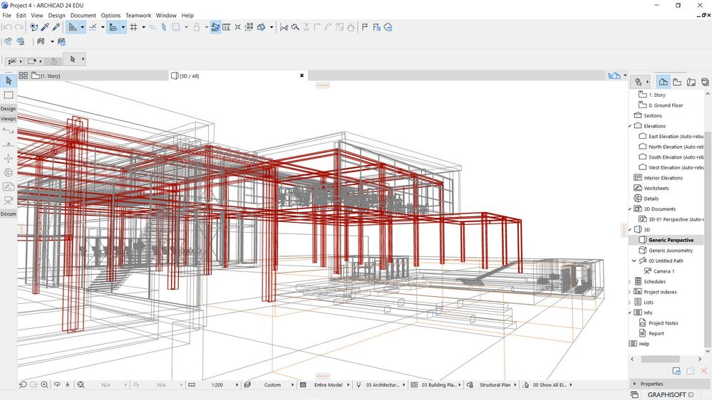

I encountered a sort of glitch in the matrix. While working on my 3D renderings my model defaulted to the wire model overlay, thus it shows none of my textures.
Is there any way I can fix this other than completely re-doing the project??
I have tried to just change 3D Style settings back to 'Simple shading with Shadows' but it remains a wire model (no matter what i have tried)
Please help!!

Check layer status, may be all layers set to Wire frame mode instead of solid mode. Share screenshots for both 3D window and layer settings in 3D window.
BCbibi72
It seems as if the settings are correct, for what i am trying to achieve...
Rajesh Patil
All layers are in wire frame mode, check third icon from left of layer name, or icon next to show hide layer eyelid. Select all layers and click on that cube sort of third icon to change in solid mode.

Head to the View Menu > 3D View Options > 3D Styles set the 3D Engine to OpenGL (AC24) click OK and the model will be rendered with textures if it's not already.
