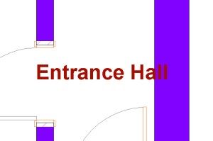

A quick question (hopefully) - can anyone tell me how to insert a return into a zone name? As you will see in my screen shot, I need to move the 'Hall' in Entrance Hall to a second line. (The text displayed is a zone name).
I'm guessing I need to alter the zone stamp's script - if this is the case can anyone point me in the right direction to do this?

If the Powers-That-Be will forgive a little shameless self-promotion:
My "SuperZone" object on Objects Online does exactly that, and a whole lot more.

/n
will work in any zone (or ID text or section name)

Aussie wrote:
/n
Not so great for schedules though
To be more specific you would type ENTRANCE \nHALL to separate into two lines. The second line, however, will overlap Room No., Area, etc. if toggled on to show in the zone stamp.
