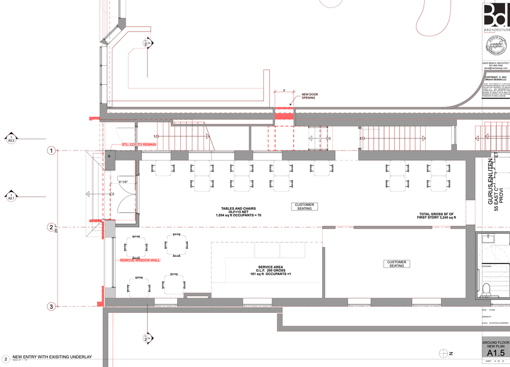

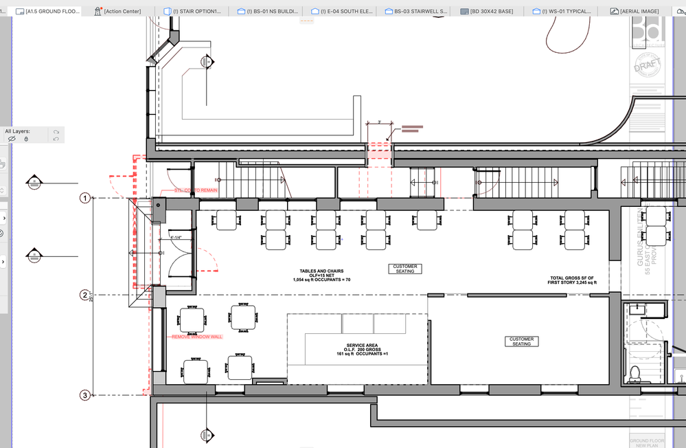

doors and window missing in reference when publishing layout
I place a floor plan reference on my layout (reference is pink).  I set the pdf in the publisher set to "print reference".  Everything looks great on the layout in the publisher set but in the pdf the doors and windows of the reference are missing.  I have attached a screen shot from the publisher set and from the pdf.

sorry here are the screenshots of my problem.

Interesting issue.
The lines and fills of the trace also seem to be publishing darker and thicker.
I don't know anyway to change this.
However, instead of using a trace reference, why not just overlay the actual view you are using for the reference.
