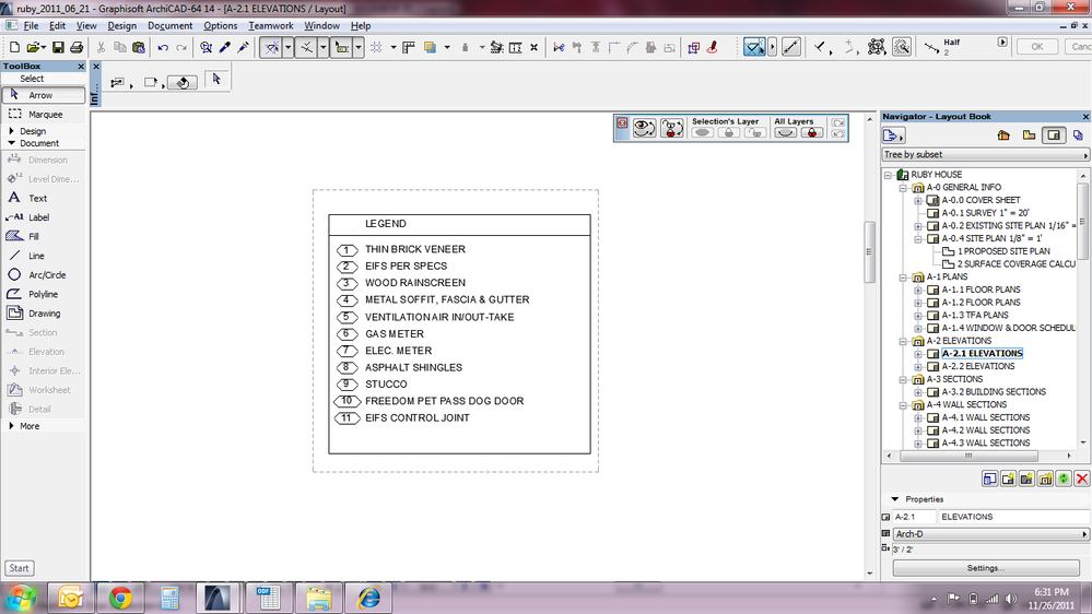

how to add a border for drawings in layouts?
Can someone tell me: how do I get the drawings in the layouts to have a visible, non-printing border (as shown below)?

On Screen View Options > Drawing Frames
See attached.

thanks Karl; you can't believe how long I searched for that.
