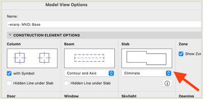

Eduardo Rolon
  • Assign an unique material for soffits
  • Go Into MVOs and create a New one for this plans
  • Select " Eliminate"

Eduardo Rolon
Yes, it will remove the line for slabs that are touching and have the same surface material and cover fill.

Eduardo Rolon
Yes you can.
