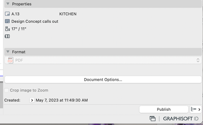

Is there some reason why I can't select a folder where to Publish? (Like folder to a specific project)? I know I can set up folder in Working Environment.... But  why it is not option to set it up when at publishing? (when I go to document settings, it's not there either)... And plus I have to set up all the time quality even though I use the same quality through all projects.

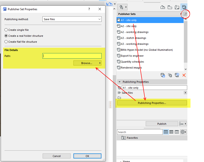

Go up one level back to the list of 'Publisher Sets'.
Select the set you want to publish and click on the 'Publishing Properties' button.
There you can browse to where you want to save the file.

I found it but in that case I can’t go back and manage pdf quality…. The setting completely disappeared …. Basically I can’t edit quality and path tag the same time. Strange

You need to go back into the publisher set (where you where before) to control the PDF quality.
You go to the publisher set list to set where they publish.
