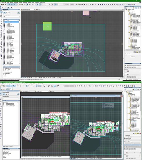

so sometimes some of my projects, size not being a factor, get the sections or elevations embedded into plan view when i try to access a section or elevation. and from then on that section or elevation cannot be erased even if i delete the 3d model. nor can i see my plan in plan view when i close the section. I have submitted bug reports but was curious to see if someone else has had this issue?
i should add if i copy the whole project into a new drawing then every works fine. sometimes forever and sometimes for a couple of days before happening again

this picture should help. basically the section gets imprinted into my plan view and cannot be removed once it happens. good thing i save a lot lol

Its not trace and reverence, i can actually select and delete the section pieces out of the plan view and when i do it removes the actually wall, roof, etc but deleting the wall or roof from plan view does not remove it from the overlayed section.

I had it occur ONCE in v19 on a project started in v17 and then migrated to v18. Never had it happen again.
I guess I can't really offer any advice other than it may be a rare migration bug?

THIS IS THE PROBLEM!
I have been using a modified template that was initially created in v 15..... There is so much work into it that i have not taken the time to recreate it with each versions. maybe there are some remnants of something that are plaquing me. As soon as v20 is downloadable i will be making a new template from scratch. ugh... 15 options using renovation filters is exhausting and so tideous...
