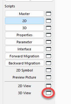

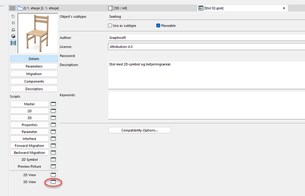

I am a teacher of BIM in general and Archicad in special. Just now I teach "Scripting in Archicad". The problem is that we don't see the 3D View in the GDL script. I suspect it is a missing feature in the student version. Anyone who can confirm this?

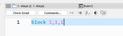

Have you tried making a new object with just something simple like;
BLOCK 1,1,1
and seeing if that shows up in the 3D preview?

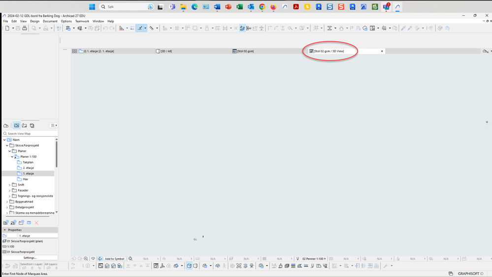

I have tried both very simple home made objects like a cube as you suggested, and gs objects. No trace of anything but a symbol in the 3D view in the GDL editor. Fit in Window doesn't help.
All the students experience the same problem. No visible object in the 3D View in the GDL editor.

Now one of my BIM-students, Adrian Sørensen, has found it out. Probably something in the Norwegian version of the template. When in the GDL editor, you have to open Parallel Projection Settings and choose a random view. Then you will see the element in 3D View in GDL. Solved 😀
