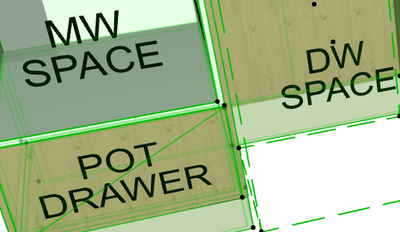

As the title says, is it possible to remove the outline around 3D text in the object? I'm trying to add a toggle to be able to show / hide the outline.

The 3D text object that comes default in the Graphisoft library just uses a 'TEXT' command in the 3D script.
So you can't turn the outline off.
You can however add a PEN command and set a very thin white pen (can't be pen 0 or -1).
You have labelled the post '3rd Party Objects'.
If it is a third party object, it may be scripted differently - but I doubt it, as I don't think there is an easy way to convert TEXT into a PRISM_.

PLACEGROUP ISECTGROUP{3}(Oversized_Block_Text_Is_Cut_From_Group, Text_Block_Group, 0, 0, 0, 1)
A thin white line becomes a wider white line in a pdf, so i don't use the white line trick.
ISECTGROUP
ISECTGROUP (g_expr1, g_expr2)
ISECTGROUP{2} (g_expr1, g_expr2, edgeColor, materialId, materialColor [, operationStatus])
ISECTGROUP{3} (g_expr1, g_expr2, edgeColor, materialId, materialColor [, operationStatus])

Example....
ThreeDeeText = "PLACE TEXT HERE"
GROUP "Oversized_Block_Text_Is_Cut_From_Group"
   material "BLACK"
   ADD -1.500,-0.00500,-0.100
   BLOCK 3.000,0.00399,0.200
   DEL 1
ENDGROUP
GROUP "Text_Block_Group"
   material "BLACK"
   pen 1
   MODEL SOLID
   rotx 90
   text 0.002,0,ThreeDeeText
   del 1
ENDGROUP
PLACEGROUP ISECTGROUP{3}("Oversized_Block_Text_Is_Cut_From_Group", "Text_Block_Group", 0, 0, 0, 1)

Hello JGoode.
Make a group "TEXT 3D"  and then place it using  CREATEGROUPWITHMATERIAL .
group "TEXT 3D"
_ _ _ _
endgroup
j1=0 ! replace pen,
j2=0 ! replace material,
j4=1 ! make edges invisible.
pen_=2 ! replacement pen index.
material_=0 ! replacement material index.
repl_directive = j1 + 2*j2 + 4*j3 + 8*j4
placegroup CREATEGROUPWITHMATERIAL ("TEXT 3D" , repl_directive, pen_, material_)

For those following along, the 3D text code can now be ...
	Text txt_thk,0,Elev_Txt_Str
ENDGROUP
!PLACEGROUP "Text_Block_Group"
!! Text !!
Material Elev_Txt_Mat
add 0,0,Elev_Txt_Hgt+Elev_Txt_size*0.5
ROTy -incl_txt
ROTx 90-roll_text
if SYMB_MIRRORED=1 then
	mulx -1
endif
pen 1
PLACEGROUP CREATEGROUPWITHMATERIAL ("Text_Block_Group", 1*0 + 2*0 + 4*0 + 8*1, pen_numb, material_index)
del 1
del 1
del 1
You could even add a parameter now to turn the invisible edges masking value on or off, which is exactly what JGoode wants.

The reason i don't use the CREATEGROUPWITHMATERIAL command is because in acrobat you still get funny things happening with the text,
left size is the ISECTGROUP, right side is the CREATEGROUPWITHMATERIAL
it looks different from the text box, labels, etc.
at 100%
at 150%
at 200%
in 3D
its an acrobat thing....
