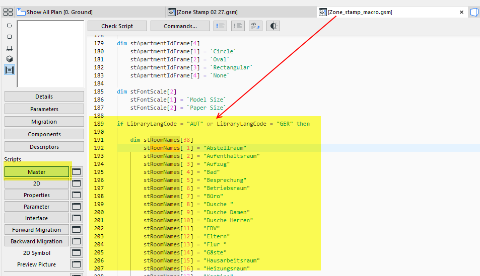

is there a possibility to change the default name settings in zone tool?

Hello,
maybe someone knows how to solve this problem in ArchiCad 27. Because in "Zone_stamp_macro.gsm" version 27 can't find these lines.
2023-10-26 10:50 AM - edited 2023-10-26 10:51 AM
It is there in the Master script - line 189.
