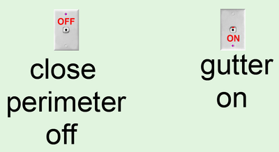

For example I have a gutter/fascia object that is a stretchy polyline object.
To the side I have added a hotspot that can have two positions +75mm & -75mm.
These then set a boolean parameter to 1 (on) & 0 (off), or in my case a text parameter "On" & "Off".
Turning that parameter "On", or moving the hotspot in plan, then activate a whole bunch of more hotspots that are also on/off or a grid of positions where each position sets a parameter that chooses a different gutter or fascia profile.
So basically it is just hotspots with set positions, that in turn set the value for other parameters.
Just to be 'cute' I added a picture of a light switch to the on/off hotspots.
Unfortunately I can't share the actual object, but if I get some time on the weekend I will try to strip out some of the hotspot scripting and post it here.

Will GLOB_FEEDBACK_MODE help there?
I use that to draw a RECT2 around the text of an object when I am stretching a hotspot to move the text.
It is only visible as you are moving the hotspot.
if GLOB_FEEDBACK_MODE = 1 then
	line_type "Solid Line"
	RECT2 -text_wid*0.5,-height*0.5,text_wid*0.5,height*0.5
endif
You would just need to draw something that represents the position of the 3D object.

@Barry Kelly 's only gone an bloody done it! 😍
That's exactly what I'm looking for!  Thank you so much.
