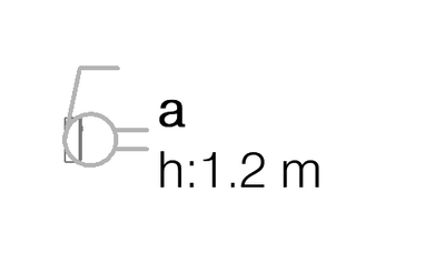

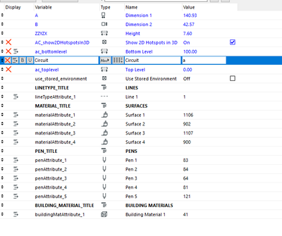

I´m trying to build an electricity socket that is 3D modelled but in floor plan it only shows a 2D symbol with a editable text (for the circuit) and an autotext for its elevation to home stroy.
The idea is, circuit goes above (and it´s a manual input)
Height goes below (it´s basically a height from home story or bottom level maybe)
that´s the parameter for circuitthat´s the parameter for circuitcircuit goes above, height from home story goes belowcircuit goes above, height from home story goes below
This is what I have in the 2D script, I just need to know how to call the height in meters please.
paragraph "AC_PRG_13" 1, 0, 0, 0, 1
pen penAttribute_4
set style "AC_STYLE_1"
circuit
endparagraph
paragraph "AC_PRG_14" 1, 0, 0, 0, 1
set style "AC_STYLE_2"
"h:"
"1.2"
" m"
endparagraph

I would script this type of object so that it's origin is at your floor level, in which case you would use zzyzx to offset the object vertically. This value can then be inserted as a parameter where required.
If you are not doing that, you could use
GLOB_ELEVATION - GLOB_HSTORY_ELEV

Thanks but I tried with GLOB_ELEVATION - GLOB_HSTORY_ELEV and Archicad returns a "string type expression required in line...."

You need to convert the number to a string ... STR("%m", GLOB_ELEVATION - GLOB_HSTORY_ELEV)

Thanks a lot, It worked!
