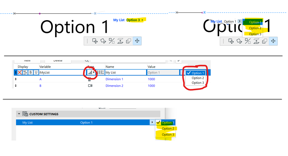

Hi all,
Is there some way to get the Hotspot Display Parameter to show a Values{2} Description instead of the numeric expression?
Ling.

Hi Ling,
I agree with Bruce, arrays are a great way to control this kind of thing. Are you trying to display you Values list when you are dragging your hotspot, as opposed to the index? Please see attached image.

Not quite sure what you are trying to achieve here. But if you are trying to get the Values list options to show and display as you are dragging, then you can always make 2 values statements. One for a string and one for an integer. You can use an IF statement to link these parameters so that they are always being updated when each one is changed. You can allocate the "Integer" values list to the value in your hotspot and the "String" values list to the display parameter in your hotspot.
I have attached an example. But not sure if this is what you are trying to do.
Cheers,
Shaun.
