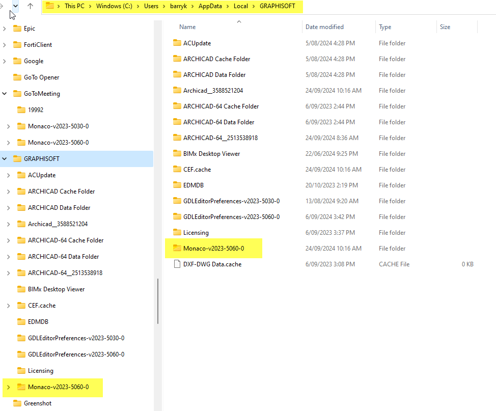

I am not 100% sure on this, but I believe these new GDL features are controlled by some additional programming language (JSON?) and these files seem to be in the User profile (hidden AppData) in a folder called 'Monaco' (on a Windows machine anyway).
I just tried deleting that folder, and restated Archicad, then opened a GDL object.
To begin with it seemed just a plain editor, but then it re-built and all the new features came back.
And in the user folder there was now a new 'Monaco' folder.
So it is obviously automatically being re-built, but from where I don't know.
Maybe if we can figure out how to turn it off, we can go back to just a plain editor.
