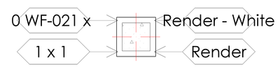

The contents macro has an odd return when it comes to the BM of columns...
Maybe that is when the Skin List Label is not available for columns...
Ling.
ps. The BM_ID return seems to be empty in AC28+...
