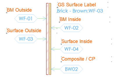

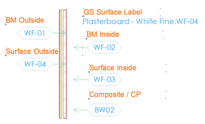

Turns out that the Label Content Macro has a bug when it comes to surfaces...
If you flip a wall, the label inverts the inside and outside...
Ling.

Looking more into it, it is less a bug, more an inconsistent behavior and UI issue. The macro pulls Wall_Mat_A and Wall_Mat_B which have an origin direction, which is relevant for doors and windows, and hence swap if a wall is flipped. I have detailed it in ticket #282137. I will see if the Wall_Flipped parameter can be used to make my BMat return consistent with the displayed surface. The macro UI is for GS to fix...

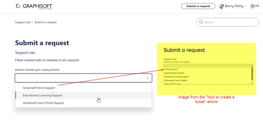

@Benjamin Dani
If this is the way we should be submitting support tickets, could we please have that page fixed so that it shows the ticket types as shown in the how to submit article.
Every time I have tried to use it, there is no "Product Support' Option.
I have even tried in a new browser and accepted "all cookies" and it is the same.
This is what I see ...

I submitted a ticket, including a link here, yesterday under Learn Portal as it was the closest to being on topic... I got a reply from Ashley Clayton containing a link to this forum as well as one to the submit request page... *facepalm*
