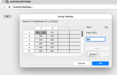

How to show array values in the User Interface?
I would like to use Arrays, but when shown in the UI, it seems you can only show the full Array:
Can you show and edit a single array item?
Thanks,
Jeroen
1 Solution
Domagoj Lukinic
I would use a loop, if you need to list all the rows at ones use vardim.
yUI=5
for i = 1 to vardim1(array1)
	ui_infield{2} array1[i][1], 5,  yUI, 90, 15
	yUI= yUI+25
next i
ofc you can use your own variable to control the number of rows you want

Jeroen
Graphisoft Partner
Graphisoft Partner
Thanks a lot Domagoj!
