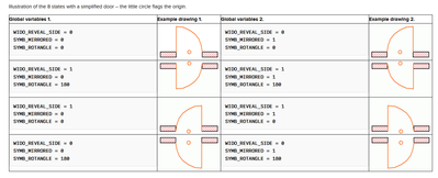

I'm trying to place a marker in the direction the door opens, is there a way to tell them apart? I
LeeJaeYoung
I would be grateful if you could tell me where to look.
AC27 on window 11
2 ACCEPTED SOLUTIONS
Solution
AllanP
https://gdl.graphisoft.com/reference-guide/doors-and-windows
that is how direction is determined.

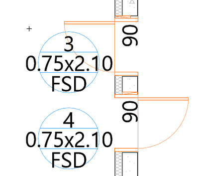

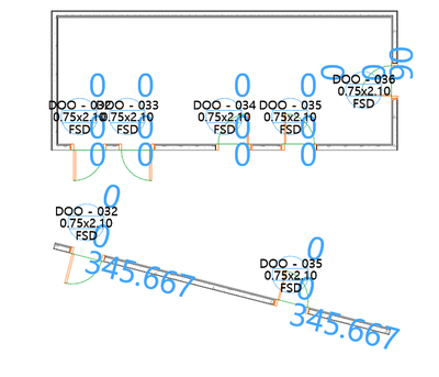

text2 0,1.8,windo_reveal_side
text2 0,0.9,symb_mirrored
text2 0,0.3,symb_rotangle
in Door
in Marker
What you've told me can't be applied to markers.
I now want to position the markers.
However, I am not getting the direction right.

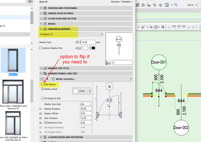

Are you trying to script your own marker in the door object (i.e. just text and a circle in the door object)?
Or are you just trying to script your own marker that you can use with a door?
If you use the default marker objects they automatically position with the door swing with an option to flip if you want to.

I am coding in GDL.
I think I found what I was looking for in your previous answer.
thank you
But I don't know if it's right.
Later, when my skills improve a lot, I will have to study Marker in depth.
And in Korea, the form used is different.
So I am studying GDL. So you can use it in practice.
It would be more helpful if you showed me the code for this part you said, but I will study more later. ^^
