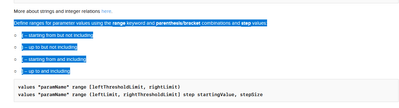

Square bracket  [  will incorporate <=, round bracket  (  is just <

AllanP
the parameter range
https://gdl.graphisoft.com/gdl-basics/parameter-logic
so
values "MyParameter" RANGE[0,10]
will start at 0 (Include 0) and go to 10 (include 10)when using "[" square bracket
i.e. from 0 to 10
values "MyParameter" RANGE(0,10)
will start after 0 (Not include 0) and go to just before 10 (not include 10)when using "(" curved bracket.
i.e. from 0.001 to 9.999
your example:
RANGE(5, 10]
 has "(" curved bracket to begin, so 5 is not included at the beginning of the range
 has "]" square bracket at the end, so 10 is  included at the end of the range,
i.e. from 5.001 to 10
